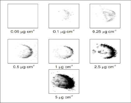

1. Swipe the surface with a slightly wetted detector and let dry
2. Compare with a calibration chart
With due care this method will reveal the presence of surface chlorides down to the 0.1 mg cm-2 level.
