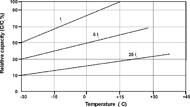

Capacity of a lead-acid battery
Effect of high discharge currents and low temperature
The basic current (I5) unit in this figure corresponds to a discharge rate of the battery in 5 hours (see here for more)
