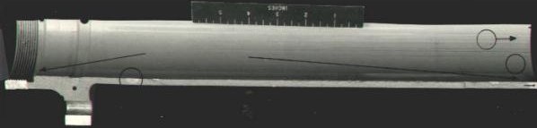

Figure 5 A semi-circular crack originated from a pit that was found on the inner surface of the shock-strut cylinder (shown by an arrow pointing a circle).
