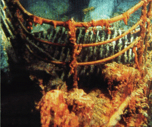

The most obvious corrosion products on the Titanic are rusticles. They resemble stalactites and can reach lengths of tens of centimeters. The rusticles have a smooth red outer surface made up of iron oxyhydroxide. When a rusticle is broken open the core is a bright orange color. The needle-like crystals that make up the core are called 'goethite' [FeO(OH)].
Rusticles covering Titanic bow When a biological activity test was performed it was shown that the rusticles grew in the presence of bacteria. The bacteria are a sulfate-reducing species that grow rapidly under anaerobic (no oxygen) conditions.
[IMAGE OF RUSTICLES ON THE BOW OF THE TITANIC] http://www.cheminst.ca/ncw/articles/1994_titanic_e.html
