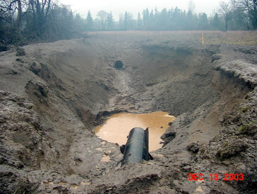

On December 13, 2003 the Williams 26-inch line ruptured near Toledo Washington. The pipeline company that supplies most of Washington's natural gas was ordered on 19 December 2003 to all but shut down its trunk line from Canada to Oregon after federal safety inspectors determined frailties in the 268-mile pipe would 'likely result in serious harm to life, property and the environment.' (picture courtesy)
