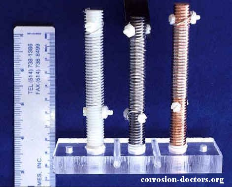

The wire-on-bolt test was first described in 1955 [1], and has since been used extensively under the name CLIMAT Test (CLassify Industrial and Marine ATmospheres) to monitor atmospheric corrosivity. These units have been utilized successfully around the world in marine and industrial type atmospheres. The procedure was originally called a "wire-on-bolt" test, because the devices consist of a copper or steel bolt around which an aluminum wire is wrapped.
CLIMAT device: Al wire wrapped on (from left to right), Nylon, Steel, and Copper rod.
The Al-Steel and Al-Cu, wire and bolt combinations have varied sensitivities depending upon the atmosphere. This is due to the variation in the galvanic corrosion between the materials. It has been reported [2] that the Al-Cu combination responds strongly to both marine and industrial sites, whereas the Al-Steel combination responds strongly only to marine sites and is relatively indifferent to industrial sites.
The percent mass loss from the Al-Steel combination is generally regarded as the marine corrosion index (MCI) and the percent mass loss from the Al-Cu combination is generally regarded as the industrial corrosion index (ICI). The percent mass loss from the Al-Nylon combination is known as the atmospheric corrosivity index (ACI). Based on the MCI the following classification of marine atmospheres has been proposed:
