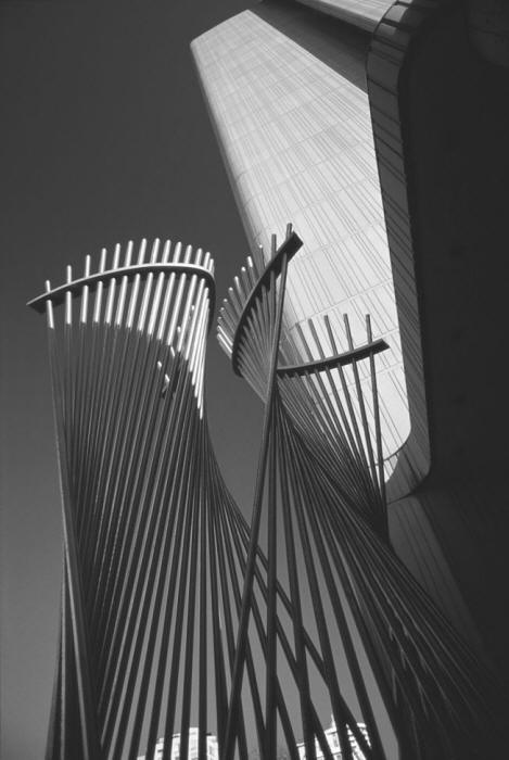

Very little needs to be said about the behavior of stainless steels (Types 200 and 300), which contain high percentages of nickel and chromium, except that they can keep their shiny aspect without tarnishing for many decades as illustrated in “The Mudra”, shown in the following Figure , which was erected in the busy part of Toronto in 1974. The steels containing only chromium (Type 400) as the principal alloying constituent tend to rust superficially, but the others are relatively free from surface atmospheric corrosion. Many of them are susceptible to SCC in many common environments.
Toronto stainless steel sculpture the ‘Mudra’ by Ted Bieler completed in 1974. (Photo by Tom Skudra courtesy of the Nickel Institute)

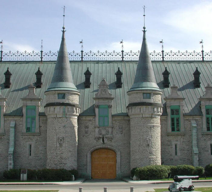

Extensive tests have been made of the corrosion resistance of copper and its alloys to various atmospheres. Various alloys were exposed in rural, industrial, and marine atmospheres for periods of up to twenty years. From data accumulated in these tests and the calibrations of relative corrosivity of the test sites, a fairly clear picture can be obtained of the corrosion behavior of copper. In addition to the corrosion penetration rates, one must be mindful of dezincification of brasses and selective attack on some bronzes, as well as SCC illustrated by season cracking of brass. These types of corrosion contribute to the failure of the material in mechanical respects without significant weight changes or losses in thickness.
Where copper is used as flashing on roofs, corrosion has been encountered at the edge of the shingles as a continuous groove. This effect is more pronounced when the atmosphere contains both chlorides and sulfides, and with wood shingles as compared with roofs of other composition. Tests indicate that all-copper roofs 0.5 mm or more in thickness such as the roof in the following picture would last several centuries in an industrial atmosphere.
Green copper roof on Quebec Armory
If the green patina on copper alloys is desired for aesthetic reasons, pre-treatment of the surface with appropriate passivating solutions is recommended. If oxidation by sulfur compounds precedes the desired reaction, the surface will present only a dark brown color for many years.

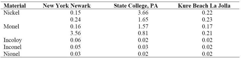

Electrodeposited nickel and electroless nickel are widely used as a protective coating for atmospheric exposure, and some nickel alloys, while, selected for other reasons, are also exposed to atmospheric corrosion. The results shown in the following Table were obtained for several representative alloys. As can be concluded from the data, nickel tends to be passive in a marine atmosphere. The ratio between the corrosion rate for nickel exposed to the industrial atmosphere and that exposed to rural or marine atmospheres was 28:1.
Corrosion in mm/year of nickel and its alloys in various atmospheres.

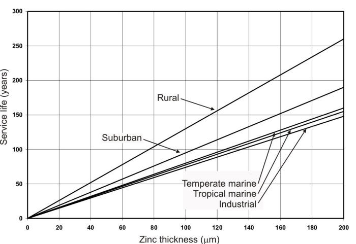

Galvanized steel is the most important application of zinc. Worldwide, the use of zinc for galvanizing results in an annual consumption of more than three million tons of zinc, constituting nearly one-half of the world zinc production. Most of these are hot-dipped galvanized coatings containing a small amount of aluminum. Thickness of electroplated coatings is considerably lower than those applied by the hot dip process. Galvanizing produces a zinc coating on the steel surface and is one of the most effective methods for corrosion protection of steel. This is attributed to the excellent corrosion resistance of zinc coatings, particularly in atmospheric environments.
Corrosion rates for zinc, like other metals can vary by as much as two orders of magnitude in atmospheric environments depending on the specific environmental conditions. Therefore, it is important to know the specific corrosion rate in a given application environment in order to effectively use zinc coated steels in outdoor structures. The most commonly used method for corrosion life estimation of galvanized steels has been the use of generalized values for the different types of atmospheres as shown in the following Figure.
Service life of hot-dip galvanized coatings as a function of zinc thickness and specific environments.
This method uses a generalized value to represent the corrosion rates for five predetermined atmospheric environments as a function of zinc coating thickness. Service life in Figure 9.43 is defined as the time to 5% rusting of the steel surface. It can be used to estimate the service life of a given coating thickness or to specify a coating for a given environment.
Example problem 9.8
Use one of the corrosivity maps to specify the thickness required of a galvanized coating to achieve a useful life of fifty years in the various environments described on that map.
The method is applicable to zinc-coated steel produced by batch or continuous galvanizing. It is applicable to hot-dip, electrogalvanized, and thermal sprayed coatings. However, it does not apply to coatings containing alloying elements larger than 1%. The method assumes that the galvanized product is free of significant defects that could accelerate corrosion. Additionally the service life prediction does not consider issues of water entrapment that can create severe crevice chemistry.

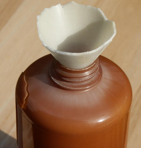

Polymeric Materials
Essentially all polymers freely exposed to the elements will change in some manner. The active rays of the sun become potent agents of change in the organic materials. Further polymerization of the resin can occur to produce embrittlement. Other types of new bonding can be triggered to make polymers more crystalline. Any volatile component of the material, such as a plasticizer, can be evaporated. The polymer chains may be simply oxidized and broken up to destroy the product. Oxygen, ozone, and moisture act with the sunlight to degrade the plastics as illustrated in the following Figure.
Plastic material degraded over a few years of exposure to sun rays on a window sill.
The external evidence of attack may be blushing (loss of gloss), chalking, or change in color of the product. This is often observed on the epoxy and polyester polymers when they have been boldly exposed to the environment. However, only mechanical tests will reveal the extent of degradation of either thermoplastic or thermosetting resins. The effect of high atmospheric temperatures or heating from direct exposure to the sun can be particularly severe on thermoplastic polymers. Creep or distension of the polyvinyl chloride and polyethylene plastics will occur readily unless provision is made to prevent overheating or stressing of the materials. Certain other thermoplastics can be dimensionally stable under normal atmospheric temperatures. The strength of these thermosetting resins is not noticeably changed.
Polymeric materials should be thoroughly tested if they are to be exposed freely in the atmosphere. ASTM Recommended Practice D1435 describes the appropriate conditions for such a test exposure and suggests tests that might be used to evaluate changes in the materials. Changes in mechanical and physical properties of the polymers are determined for definitive results. Weight gains or losses can be of interest, but do not provide substantive results. Accelerated cabinet testing of the materials can be performed with essentially the same validity as when testing metallic materials. Poor materials can be eliminated, but extrapolation of the data to forecast the life of plastic parts in the atmosphere should not be attempted. ASTM D1499, D 2565, and G26 may be used to ensure the controlled cabinet testing of the plastics. ASTM D750 should be used for the evaluation of the elastomers.
The preventive measures used to ensure the integrity of polymeric materials are similar to those for metals, i.e., the exterior should be covered. The exterior surfaces are painted or metal plated to provide a barrier between the material and the atmosphere. Alloying of the basic material with small amounts of other resins can often upgrade the stability of the material.
