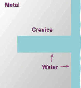

Crevice Corrosion
The chronology of a Crevice
Stage One, Induction
Stage one of a crevice formation
At time zero, the oxygen content in the water occupying a crevice is equal to the level of soluble oxygen and is the same everywhere.
