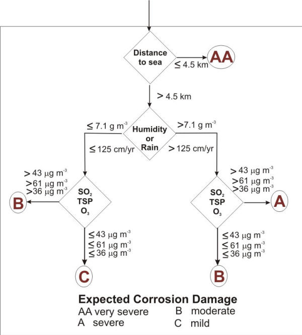

An environmental corrosivity scale, based on atmospheric parameters, has been developed over the years for the maintenance management of structural aircraft systems. A corrosion damage algorithm (CDA) was proposed as a guide for anticipating the extent of corrosion damage and planning maintenance operations. This classification scheme was developed primarily for uncoated aluminum, steel, titanium and magnesium alloys exposed to the external atmosphere at ground level. The section of the CDA algorithm presented in the following Figure considers distance to salt water, leading either to the very severe AA rating for close distance to seashore or a consideration of moisture factors.
The PACER LIME algorithm for determining the corrosion severity for a given location.
Following the moisture factors, pollutant concentrations are compared with values of Working Environmental Corrosion Standards (WECS). The WECS values were adopted from the 50th percentile median of a study aimed at determining ranges of environmental parameters in the U.S. and represent “average of averages”. For example, a severe A rating would be given if any of the three pollutants considered in this scheme, i.e. sulfur dioxide, total suspended particles and ozone levels, would exceed the WECS values in combination with a high moisture factor.

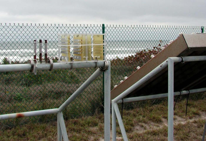

The data are collected for metals directly exposed to the outdoor environment in a standard sample mounting configuration and test package. A typical plastic test rack with its metallic coupons is shown in the following Figure besides a CLIMAT coupon exposed at the KSC beach corrosion test site.
Metal coupons in a plastic test rack exposed at the Kennedy Space Center beach corrosion test site besides a CLIMAT coupon. (Courtesy of Battelle Institute)

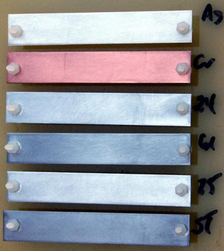

The following Figure shows a close-up view of the coupons before exposure.
Metal coupons before exposure to the environment. (Courtesy of Battelle Institute)

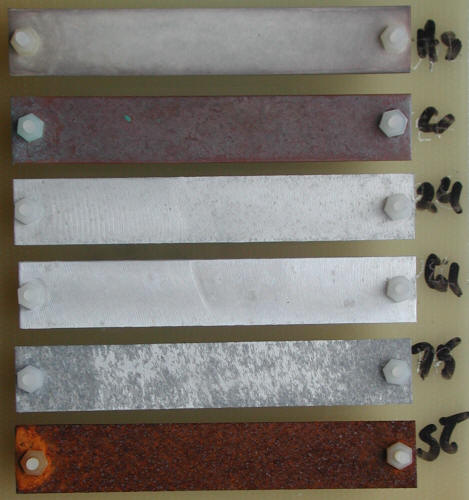

Once exposed to the environment for a given period of time the corroded metal strips such as shown in the following Figure would be sent back to the laboratory for mass loss measurements following standard methods and further analysis.
Metal coupons before exposure to the environment after a three month exposure in a rural environment. (Courtesy of Battelle Institute)
