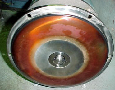

Rouging of Stainless Steel
You have just installed an all clean and shiny stainless steel water system. You start up your process, confident that your contamination problems are over. But, after a few months, a water sample has a red, gelatinous substance in the sample flask. You open the system and the tank has a reddish deposit all over the inside. You open a pump and the impeller is red, the volute is red and the discharge is red. You look in the heat exchanger and see more red. The spray balls have red streaks around the orifices. What went wrong? Why is good stainless turning red? (reference 43)

Type 316L stainless steel is the usual material of construction. Some of these systems remain clean, but others begin to rouge. Even electropolished systems with an average surface roughness less than 10 microinches (<10 m-in Ra) can rouge. In the presence of hot high purity steam these systems turn black, sometime glossy black, sometimes powdery black.
Sections of rouged stainless steel piping were obtained from a number of different pure water and steam systems. The rouge layers were examined using X-Ray Photoelectron Spectroscopy (XPS), Energy Dispersive Spectroscopy (EDS) and Scanning Electron Microscopy (SEM). The SEM allows visual examination of the surface, EDS allows spot analyses of surface anomalies, and XPS allows layer-by-layer analyses of the rouge deposits and identification of the molecular species. Comprehensive reports of the findings are given elsewhere 1,2. This work allowed rouge in pure and high purity water and steam to be classified as Class I, Class II and Class III rouge depending on the mechanism of formation.
Class I rouge comes from an external source. Rouge particles are deposited on stainless steel surfaces, and in the early stages of deposition can be easily wiped clean. Surface composition of the stainless steel passive layer under the rouge is unchanged from that of the originally installed system. The rouge particles usually have the same composition as the material from which the particles came, certainly not that of corroding stainless steel. Rouge concentration is heaviest near the source and decreases with distance from the source. Color of the rouge may change with distance from the source, being orange to red-orange near the source and changing to magenta some distance away. The color comes from the presence of the various iron oxides and hydroxides. The orange oxide is the lowest valence state for iron hydroxide and forms when both oxygen and water are present:

Pumps are prime suspects in an otherwise clean system. Two mechanisms appear to be the cause of pump induced rouging: cavitation and erosion because of impeller velocity. Cavitation usually results from inadequate water supply to the pump, improper pump selection, operation or excessive throttling during operation. Bubbles impact on a pump surface and implode, resulting in a shock wave that removes a small particle of stainless steel. Once the particle is free in the water stream it eventually is attached to the stainless steel piping by electrostatic attraction. Because the particle surface is not passivated, it immediately begins to oxidize and turn red.
Erosion of the impeller is another possible mechanism. Every material has a critical velocity above which erosion accelerates3. For low alloy austenitic stainless steels this critical velocity appears to be around 100 fps. Erosion rate will vary with temperature. Type 304 Stainless Steel appears to have a constant erosion rate up to 600° F (300° C) then increases rapidly. Specific data in high purity water for the different alloys are not available.
The metallurgical condition of the impeller seems to have an influence on the rate of metal removal. When the austenitic family of stainless steel solidifies from the melt two metallurgical phases are present, austenite and delta ferrite. Delta ferrite formation is dependent on the composition of the alloy and if it is less than 8% it can be dissolved by heat treatment. Cast impellers generally have high delta ferrite because of higher silicon added to promote fluidity of the steel during casting. This means heat treatment may not dissolve all the delta ferrite. The reason delta ferrite is a problem is because it erodes more easily than the austenite and is higher in iron. An eroded surface of a cast impeller is illustrated in Figure 3 and rouged pump parts are illustrated in Figure 4.
