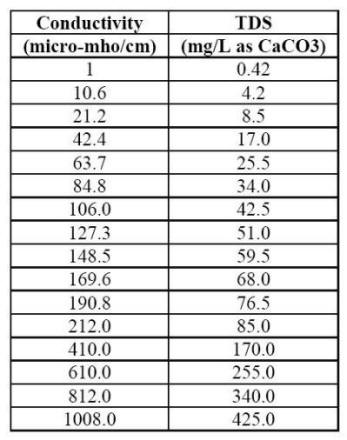

The LSI is probably the most widely used indicator of cooling water scale potential. This index indicates the driving force for scale formation and growth in terms of pH as a master variable. In order to calculate the LSI, it is necessary to know the alkalinity (mg L-1 as CaCO3 or calcite), the calcium hardness (mg L-1 Ca2+ as CaCO3), the total dissolved solids (mg L-1 TDS), the actual pH, and the temperature of the water (oC). If TDS is unknown, but conductivity is, one can estimate mg L-1 TDS using the following conversion Table.
Conversion table between the conductivity of natural water and the total dissolved solids (TDS) it contains.
