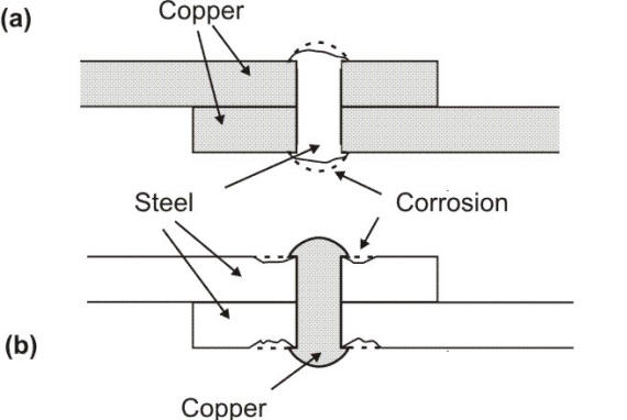

This area effect in terms of current density is illustrated by combinations of steel and copper as either plates or the fasteners used to join them and immersed in a corrosive solution. If steel rivets are used to join copper plates, the current density on the relatively large cathodic copper plates will be low, cathodic polarization of the copper will be slight, and the voltage of the galvanic couple will maintain a value close to the open circuit potential. At the same time, the current density on the small anodic steel rivets will be high and the consequent corrosion quite severe, giving rise to a particularly vicious form of corrosion called galvanic corrosion.
Galvanic coupling caused by riveting with dissimilar metals: a) steel rivets on copper plates, b) copper rivets on steel plates
With the opposite arrangement of copper rivets joining steel plates, the current density on the copper cathodes will be high, with consequently considerable cathodic polarization of the copper reducing the open circuit potential below its initial value. The diminished anodic current will be spread over the relatively large steel plates and the undesirable galvanic effect will hardly be noticeable.
Open circuit potential measurements are grossly inadequate for predicting the magnitude of galvanic effects since they do not take into account area and polarization effects. They are reliable only for predicting the direction of such effects.
