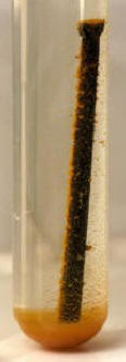

So, you are wondering, how did we make these experiments.
For the first experiment we put a 5 cm finishing nail brushed with steel wool in a test tube containing 8 mL of tap water. The picture was taken three days later.
