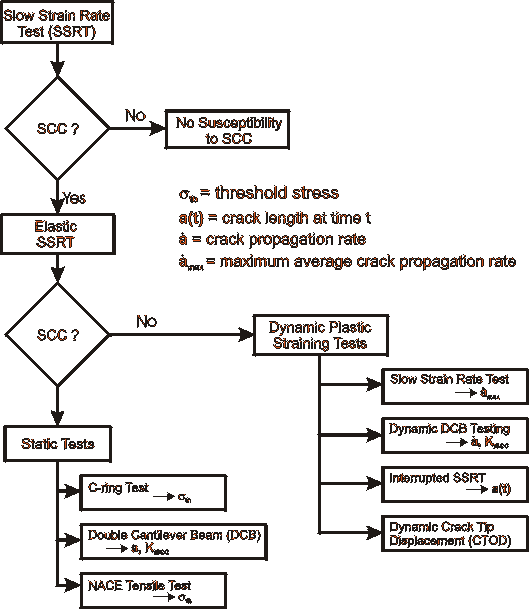

An efficient strategy to carry out a test would be to start with the most severe and least expensive SCC test, i.e. the slow strain-rate test in which a bar made from the relevant material is exposed to the environment of interest and slowly monotonically strained to fracture. When cracks are found, the susceptibility of the material should then be further evaluated by performing a battery of other tests designed to differentiate between the various mechanisms leading to SCC and hydrogen embrittlement.
Decision tree for the selection of corrosion tests to verify the susceptibility of steels to stress corrosion cracking (SCC)
