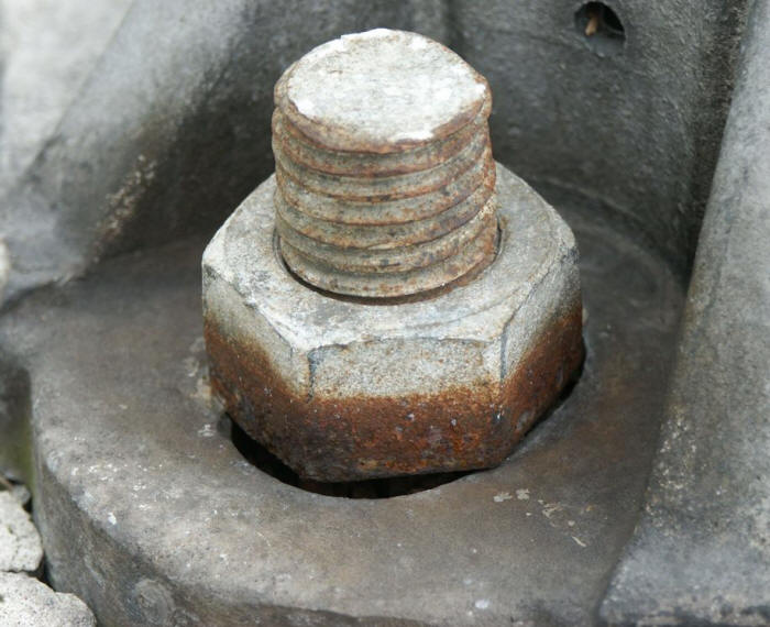

Rain also may have a beneficial effect in washing away atmospheric pollutants that have settled on exposure surfaces. This effect has been particularly noticeable in marine atmospheres. On the other hand, if the rain collects in pockets or crevices, it may accelerate corrosion by supplying continued wetness in such areas as illustrated in the following Figure.
Galvanized bolting assembly after ten years of exposure to a deicing salt environment.

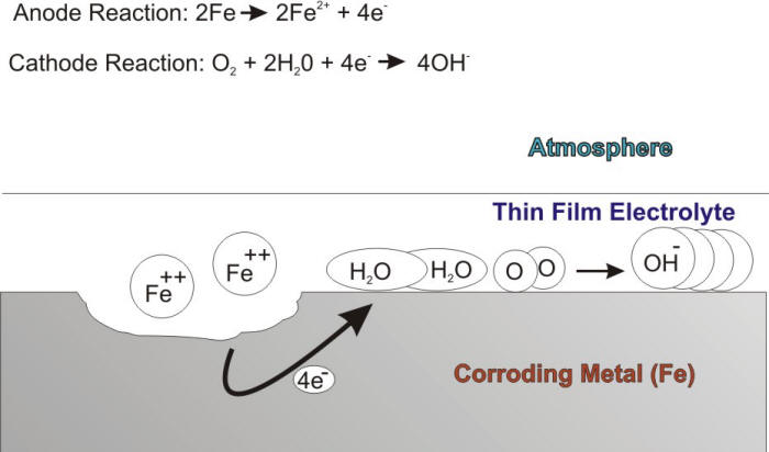

The critical humidity level is a variable that depends on the nature of the corroding material, the tendency of corrosion products and surface deposits to absorb moisture, and the presence of atmospheric pollutants. It has been shown that, for example, this critical humidity level is 60% for iron if the environment is free of pollutants. In the presence of thin film electrolytes, atmospheric corrosion proceeds by balanced anodic and cathodic reactions. The anodic oxidation reaction involves the corrosion attack of the metal, while the cathodic reaction is naturally the oxygen reduction reaction as shown in the following Figure.
Schematic description of the atmospheric corrosion of iron.
