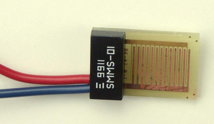

A method of measuring the TOW has been developed by Sereda and correlated with the corrosion rates encountered in the atmosphere [9]. The moisture sensing elements in this sensor are manufactured by plating and selective etching of thin films of appropriate anode (copper) and cathode (gold) materials in an interlaced pattern on a thin nonconductive substrate as shown in the following Figure. When moisture condenses on the sensor it activates the cell, producing a small voltage (0 to 100 mV) across a 107 W resistor.
Interlocking combs of gold and copper electrodes in a ‘Sereda’ humidity sensor.
Thin sensing elements are preferred in order to preclude influencing the surface temperature to any extent. Although a sensor constructed using a 1.5-mm thick glass reinforced polyester base has been found to be satisfactory on plastic surfaces, this will not be the case with the same sensing element on a metal surface with a high-thermal conductivity. For metal surfaces, the sensing element should be appreciably thinner. Commercial epoxy sensor backing products of thickness of 1.5 mm, or less, are suitable for this purpose.

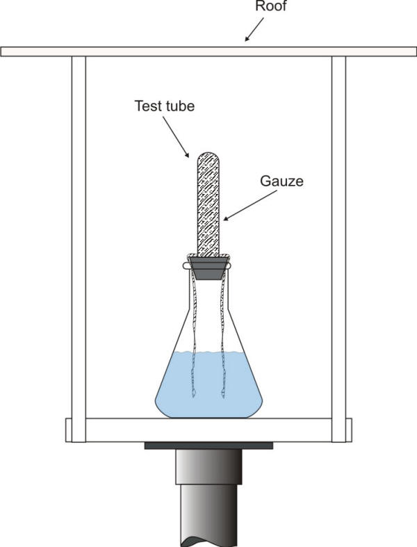

A number of methods have been employed for determining the contamination of the atmosphere by aerosol transported chlorides, e.g. sea salt and road deicing salts. The ‘wet candle method,’ for example, is relatively simple, but has the disadvantage that it also collects particles of dry salt that might not be deposited otherwise. This technique uses a wet wick of a known diameter and surface area to measure aerosol deposition as shown in the following Figure.
Schematic of a wet candle chloride apparatus.
The wick is maintained wet using a reservoir of water or 40% glycol/water solution. Particles of salt or spray are trapped by the wet wick and retained. At intervals, a quantitative determination of the chloride collected by the wick is made and a new wick is exposed.
In reality, the wet candle method gives an indication of the salinity of the atmosphere rather than the contamination of exposed metal surfaces. The technique is considered to measure the total amount of chloride arriving to a vertical surface and its results may not be truly significant for corrosivity estimates.

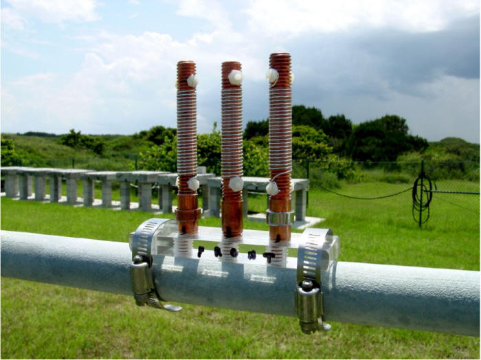

Some variations of the basic coupon specimens can provide rapid material/corrosivity evaluations. The helical coil adopted in the ISO 9226 methodology is a high surface area/weight ratio coupon that gives a higher sensitivity than panel coupons of the same material. The use of bimetallic specimens in which a helical wire is wrapped around a coarsely threaded bolt can provide additional sensitivity and forms the basis of the CLIMAT coupon for Classify Industrial and Marine Atmospheres.
An ASTM standard describes the construction of CLIMAT coupons. According to this standard CLIMAT coupons can be made from 1100 aluminum (UNS A91100) wire wrapped around threaded rods of nylon, 1010 mild steel (UNS G10100 or G10080), and CA110 copper (UNS C11000) [13]. The mass loss of aluminum wire after ninety days of exposure is considered to be an indication of atmospheric corrosivity. However, the relative corrosivity of atmospheres could be quite different for the various combinations of materials.
The aluminum wire on copper bolts has been found by many to be the most sensitive of the three proposed arrangements in the ASTM standard. While this arrangement is the most sensitive, the use of triplicate coupons on a single holder additionally provides an indication of the reproducibility of the measurements. A CLIMAT coupon with three copper rods was installed at the NASA Kennedy Space Center (KSC) beach corrosion test site shown the following Figure.
Aerial view of the NASA Kennedy Space Center beach corrosion test site where atmospheric corrosivity is the highest corrosivity of any test site in the continental United States.
The following Figures show the coupon shown immediately after it had been installed (a), after thirty days (b), and after sixty days (c).
a)
b)
c)
A CLIMAT coupon with three copper rods immediately after it was installed at the Kennedy Space Center beach corrosion test site a), after thirty days b), and after sixty days c).
KSC has the highest corrosivity of any test site in the continental United States. The mass loss recorded after a shorter exposure than usual can be very high. In the present example it was already 16% of the original aluminum wire after sixty days. The CLIMAT coupons sensitivity to atmospheric corrosivity can be used to study fluctuations on a micro-environmental scale.
