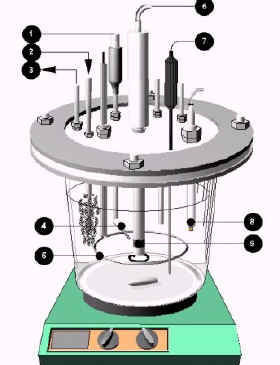

Rotating cylinder test cells can be used to accelerate the erosion corrosion effects of carbon dioxide (CO2). The diagram below shows the main features of such equipment:
1. Reference electrode
2. Gas inlet
3. Gas outlet
4. Luggin capillary
5. Platinum counter electrode
6. Rotating cylinder
8. Temperature probe
9. Water in from loop
10. pH-electrode
11. Working electrode
