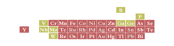

Metals plateable from aqueous solutions (red background). Elements with yellow background are only plateable in combination with one of the others (alloy plating). Grey text indicates that the element can be deposited both by an auto-catalytic electroless process or by electroplating. (reference 81)
