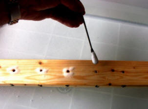

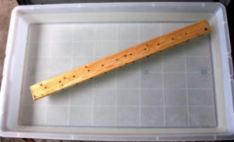

First, the torture bench. Nothing complicated, but my GOD, so powerful: simple tap water and a porous medium. The piece wood you see floating here has already had been drilled to receive twelve sacrificial lambs that will be offered to the corrosion Devil so he will not come to haunt us and lure us to the scrap yards of the world.
A wet wood board can be corrosive by retaining humidity
Adding salt to the wet wood now makes it an extremely powerful corrodentAnd then we add a little bit of salt that will really really make a big difference. Adding salt to the wet wood now makes it an extremely powerful corrodent for many metals and particularly for steel and aluminum.
After a few hours, the salt crystals had disappeared into the wet wood waiting for their prey to arrive. Salt is not rare and is a realistic aggravator. Salt is used on many icy winter roads of North America as a deicing agent. Salt is also an important component of seawater.

Just a hint: we wanted to test the corrosion efficiency as well as the penetrating efficiency of the corrosion preventive compounds.

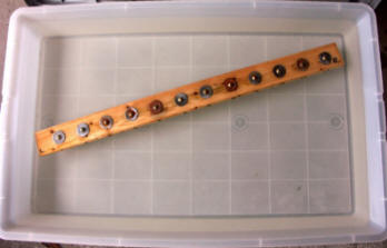

Here is how it looks after having assembled pretreated washers, bolts and nuts unto the presoaked wooden board. As you can see we have numbered each of the sample site for future reference.
In this particular test, we have tried nine commercial CPCs, two bare steel washers and one galvanized . The picture you see here was taken after two days of testing. Can you already see some serious differences between some of the test coupons?

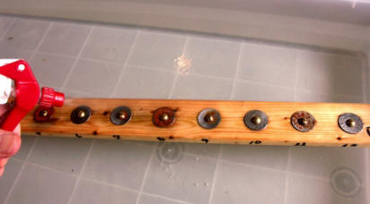

Oh, we forgot to mention another corrosion aggravating factor we introduced in the test. Alternate wetting and drying is a serious factor in many natural corrosion situations. So why not sprinkle our poor CPC prep washers with squirts of a 3% sodium chloride solution.
The corrosion race is on! May the BEST win!
